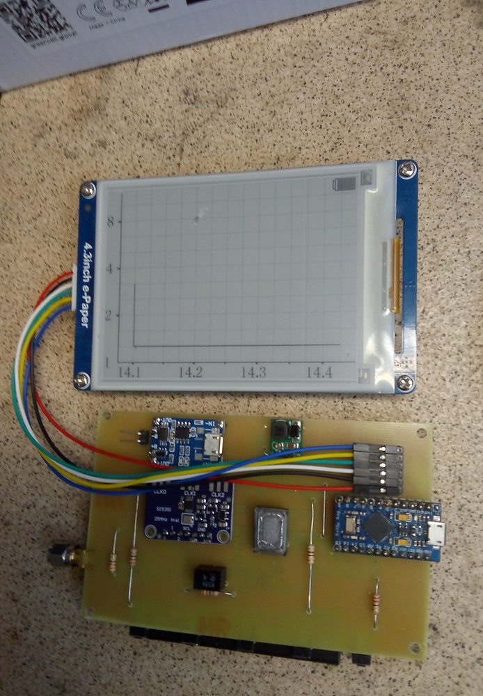

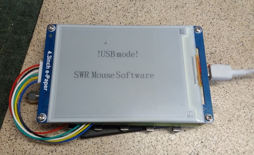

Hello. I have built this swr mouse and it works very well on the pc. I added the e-ink display control to the code, but I do not know how to calibrate the SWR value. The first measurement with an open port, the second with a 100 ohm resistor, how to correctly calculate the SWR from these values. Can you give me a hint? Can you put a mathematical formula for this calculation, or a piece of code?
Hi
You can find algorithm description and code sample here viewtopic.php?p=1213#p1213
